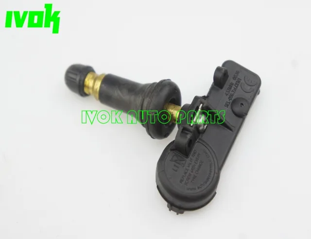

No seriously, I have a slow leak from my rear nearside tyre and it always warns me of a pressure drop, since it loses about .3 bar every couple of weeks.
After speaking with a fellow enthusiast ( Neil ! ) it appears my fault, because after the tyre blow-out I had, when I went for the new tyre fitting, I asked him to keep the valve because it has the sensor in it. This is factually incorrect, as the valve can be disposed of each time for a new one, as the sensor is held in place at the bottom of the valve by a screw.
So my tyre fitter saved my valve which now leaks due to being displaced.
Mind you if he had told me that, I would have said put a new valve on then and it wouldn't now leak.
This is the valve, note screw at bottom....
and this is the valve with sensor in place....
Images may be subject to copyright.
Hope that helps if ever anyone was wondering LOL.
